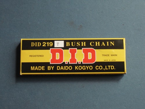

Thank you for the link for a new chain. They seem to be a hard find just Googleing to find a DID 219T chain although I did find one on ebay for about $65.00 that appeared to be in the correct packaging but the vendor you recommend would be cheaper as well as being vouched for . I have already ordered a new master link from 4into1 when I ordered a gasket and seal set and will probably order another one later as I am sure I will need to order other stuff.Since I saw no mention of how many miles are on the bike in the early part of this thread, combined with some of the sketchy work that seems to have been done on it, I absolutely agree with replacing the cam chain. And the best place to get one is here -
Honda CB 450K CL 450 Timing Chain D.I.D. 219T128 with lock timing cam chain | eBay
Find many great new & used options and get the best deals for Honda CB 450K CL 450 Timing Chain D.I.D. 219T128 with lock timing cam chain at the best online prices at eBay! Free shipping for many products!www.ebay.com
I believe his chains come with a pressed side plate master link, which I personally have never felt comfortable with so I buy DID rivet type master links from 4into1, get a couple in case you have to break the chain again before the engine is finished and in the frame
Genuine Honda - D.I.D Cam Chain Master Link - 219T - Rivet Type - CA/CB/CL72/77 CB/CL/350K/450K SL350K CB500K/550/750
Genuine Honda D.I.D cam chain rivit type master link for 219T type chain. This master link will only fit with 219T D.I.D brand chain which was the original (OEM) cam chain used on the models below.4into1.com
