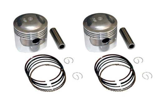

The reason they don't have piston kits is because they're selling OEM Honda parts, which all came separately from Honda as they didn't sell kits either. It's more of an aftermarket thing when it comes to hard parts like pistons and rings, since it's all aftermarket they gather all the parts you'd typically use. One exception back when these bikes were sold and worked on daily was gasket sets, Honda sold top and bottom end sets as well as individual gaskets. Notice that even aftermarket doesn't sell valve sets with stem seals and new springs either.
