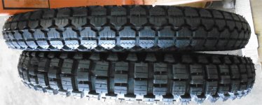

I'm having a heck of a time finding a front tire.
I'd like to find something that looks similar to the original tires.
Seems like all the 3.00-19 tires I like are out of stock everywhere. At least tires that won't break the bank.
Does anyone know if a 3.25-19 or an 80/100 would have any issues?

I do like my tires to kinda, sorta match. Maybe it's just the looks of it. I haven't really thought about my CL's tires yet, but I'm telling myself that it will be probably a C-note more than I think. That's just the new normal, I'm afraid. Are you going for the original Trials type tread, like Shinko 244 or 241?
That was my plan, however I've been rethinking that.
It might look more "period" with a Trials type pattern but it will handle better with a street tire.
LDR, thx, that's helpful.
Those Heidenau's are great tires and they look great, but for the cost I would buy them.
Still trying to decide what tires I am going to get.

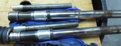

So tomorrow I pick up the frame from the powdercoaters.
I thought I'd better have a look at the forks.
The springs are a bit rusty but will clean up. The plastic bits are still intact, which is good.
The tubes have a bit of rust, which I expected and should clean up.
My cheapo HF snap ring tool broke, I guess I'll to go spend another $6 on a new one. I got my moneys worth out this one.
I was able to get one screw out of the bottom but the other one just spins. (Phillips head? Really Honda?)
I'm not surprised. Sigh. (I think the surprise was that one of them came out!)
I haven't worked on external-spring forks like these before, I'll have to see if the tricks I used for other forks will work to get that screw out.
Don't take the other one out, when they have phillips (JIS) head screws they aren't part of disassembly and if you do take them apart far enough you might have difficulty getting them tightened up when you reassemble. The ones with allens need to be removed for disassembly. These are the slide-hammer style to get the forks apart and the seal out
Ah, ok, thank you for that. The shop manual devotes exactly one sentence to disassembly and the parts diagram is a bit vague. I've only done the forks on my other bikes.
I guess I'll renew my snap ring tool and go at it from the other end.
It also looks like the seal needs to be installed over the tube, i.e. the tube goes in the lower before the seal and snap ring is installed.
Is that correct?

Yes, on those older versions you get it apart by removing the snap ring and slide-hammer the seal out, then slip the seal over the tube and use a piece of PVC to drive it in.

Those forks do come all the way apart! But I see why that shouldn't be necessary. These forks are so simple.

Not much happening. I put the forks back together but the springs still need bead blasting and paint.
I'm not going to polish the forks, they look ok and I'm just not feeling it. I'll probably rub them with a bit of aluminum polish and leave it there. Polishing sucks and my setup isn't the best so it takes a lot time.
I'm going to reuse those gaiters. Somehow they are still soft and pliable after all these years.
New tires arrived. I went with Duros.

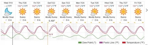

How are things going down in Texas? I assume it's very hot.
Currently 102, at 7pm.
Yes, the heat is making things move slowly and will continue to do so.
However, I have gotten most of the parts I need in so all I need to do sleep during the day and work at night! :)
I'll have some updates in a day or so.

Progress has been slow due to the ongoing perpetual heat wave but I have gotten a few things done.
Today I got the front brake plate back together with new seals and such then I got the new tires mounted.
Putting on the new tires was a heck of a lot easier than removing the 40+ year old ones.
If you change your own tires and don't have a Motion Pro Bead Buddy get one, it's worth it.
It really helps by providing a third hand when installing a tire.
