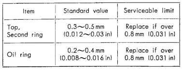

Question for those with more experience on these engines on piston ring end gap. I separated the sets by by left and right for their respective cylinders.
I checked the gap on the new rings and got the following, measured in thousandths of an inch.
Left Right
Oil 13 13
2nd 12 15
Top 12 12
My question is should I be OK with the gap at the minimum clearance on both top rings and the one 2nd ring or would I be better off taking off a bit to avoid the possible chance of piston seizure? Had a bad experience on a 650 BSA top end rebuild years ago and had to redo it. Thanks for the advice.
Yeah, I might take the 3 that are right at .012" and open them up to .014" or .015" to be safe, considering the upper limit is .031" you'll be fine.
