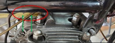

Along the way I learned that the cylinder head cover that was on this bike as I received it, is not the correct cylinder head cover for the CB. Perhaps the CL, but I never asked. The correct cover has another bolt-boss cast in roughly where the arrow is pointing to the cut off bits from the chassis which are meant to be the second engine mount tabs on the frame. Look at the picture above, and then scroll down and you will see the correct cover with the added “lug” cast in. See? I may be slow, but I am trainable.
As the days and months went by, and as I gained greater knowledge of the bike, I realized that the bike had been down on not one, but both sides at some time in its life so perhaps during one of those oopsies, the aluminum cylinder head mount was damaged and replaced with one from a CL scrambler of the era? Um, why? Parts were most likely available back then so what gives? Lord knows and if this frame could only talk?
It became prudent to measure the frame for straightness and in doing so I found no bends or kinks so decided to keep the frame choosing to remove the old now cut-off earless tabs and replace them. I found a trashed CB chassis with the needed tabs so I removed the complete tabs from the old trash, reassembled the external engine bits of the engine (crankcase, cylinders, head, upper cylinder mount) to place back in the frame as a jig to hold the tabs in place prior to welding them where they belonged. Do not forget that we repaired the enlarged front mount holes at the same time.
#10

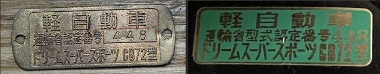

After digging a bit, I discovered that the CB72 was permitted some sort of tax break in some countries to help folks buy them and this area of the swing arm is where the “tax stamp” was attached.
In my case, and as far as I can tell with all the early-ish CB-72’s, the stamp was a riveted-on metal plaque which in later years became a stick-on printed thing. The word rivet here is a bit of a misnomer as these things which also hold on the electric start’s plaque are really what's called a drive screw, also known as a U-drive screw or hammer drive screw. This is a round-headed, unslotted self-tapping fastener that is installed by hammering rather than turning. Yuup, I’ve never heard of this. On this bike they are tiny, as in >7mm top to bottom. Here is a picture.
Looking below you’ll see that the Left picture is a rivet-on early plaque as this bike would have. But of course, it is NLA (no-longer-available.) OK, I did find a couple but they were awful IMO so I am back claiming NLA! On the right is the green stick-on stamp found on later bikes.
#13
The metal reproduction plaque done for this project mounted on this bike’s swing arm with those odd hammer-screws. The plaque is dimensionally 100% the original. And notice the new swing arm bushings as well? As previously mentioned the swing arms come with phenolic bushings (Bakelite perhaps?) but these aftermarket bronze bushes are far more robust. Admittedly this new plaque is not OE but certainly better than either of the well worn unsalvageable (to me) plates so this is a deviation that was worth it IMO.
And whilst looking, please note those bronze swing arm bushes. And too, that this swing arm is the original paint.

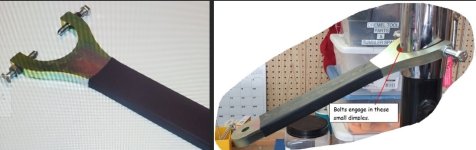

Before you can even touch the bare shock body, you must take the spring covers off. The upper cover is painted the overriding color of the bike, black in my case, and considerably thicker than the polished lower part. I'm nut sure but it is my impression that the lower covers on these early bikes are relatively rare, and are wafer thin, aluminum covers. I have some Reynolds wrap that is thicker! If memory serves, these lower covers were changed out in later years to something more robust. But lest we forget, robust is also synonymous with heavier. Removing them this is simple enough as they are held together with a pair of split collars. Getting them off poses a different problem however.
Oddly, I have several different spring compressors but because Honda covers the springs with these shiny enclosures, none of my tools would work. Thus the obvious choice for me was to use a 20 ton press. Carefully. In hind sight I could have purchased this tool from Honda Classics in the UK
Rear Shock Spring compressor.jpg 20231122_123900.jpg The tool on the left compresses the spring by depressing the black outer cover down and away from the split collars.
The only reason I did not purchase the tool was for the simple fact that I’ll bet I’ll never need this style again. However, in hindsight I feel the buck$ would have been well spent to alleviate the angst of using a press without the potential damage to the wafer thin covers. You'll hear me say it often but I am trainable.

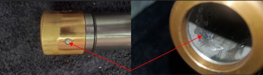

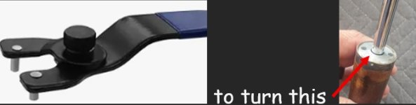

Once compressed enough, say 10mm or so, the split collars can be lifted out. Once the split collars are out the cover comes off along with the actual suspension spring. The spring sits on the shiny lower cover leaving you the bare shock! Now you are off and running!
Maybe I got too excited because you still need on last odd-ball tool, commonly referred to as a pin-spanner tool, to open the shock. If you don't have one or wish to purchase one, these are easy to make if you have some metal bits laying around. Unfortunately, I use this tool often enough to have one in my tool box.

Forks:
This early CB has the heavy-as-a-ships-anchor steel lower forks. When you look at the sheer amount of machine work to the parts, I found it all to be way cool but honestly not much to do here. Pull them apart, clean them, making sure the bushes are not worn out and that the seals are good. If you are in there, I’d replace the seals just because but you do not have to unless worn or leaking. Make sense?
I’m that dork that is lazy enough to say “self, if you re-assemble it, ride it, only to find a leak or some extra slop its guaranteed you’ll be one P-O’d son of a gun so just replace the seals while in there, OK?” Makes for happier evenings chillaxin instead of working. But then that’s just me.
Once the forks are removed from the bike and the upper fork covers and bits are off (headlight ears etc) you might end up like me wondering how in the heck the doggone thing comes apart. I first looked at the bottom where the axle goes through hoping to find a bolt where modern bike forks typically have them but nope. Scratching my head I noticed two small holes in the lower part of the chrome covers. Could those be a clue?
Short answer yes. The Chrome cover has some real beef to it and is more than just a pretty face. It is also the part (like a nut) that holds the fork together. The tool needed is also available but like anything, not too hard to make if you have the time. I am a tool junkie so purchased one.
Here is yet another time I took way too few pictures so I’ve included a picture out of the CB72 Honda parts catalogue.
Once the upper left three parts in the picture are removed (which happens as soon as you remove the forks from the triple tree) there are not too many parts involved. Other than figuring out how to pull the inner fork tube from the outer lowers which we've gone over, the only real PITA was removing the lower fork tube bushing. There are four (OK, maybe three, I forget) small tapered bushing-retainer pins that need to be pushed out but can be plenty irritating to reinstall. Once back in, they must be smooth to your finger on the inside so don’t be afraid to massage them as can be seen Honda did back in the day. This pic is before they were pulled apart. Like anything, you don't have to change the bushings. If you feel slop or can measure enough loss where you see wear patterns on the bushings, then change them. Other wise, don't bother pulling them as there is no need.
