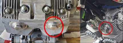

Along the way I learned that the cylinder head cover that was on this bike as I received it, is not the correct cylinder head cover for the CB. Perhaps the CL, but I never asked. The correct cover has another bolt-boss cast in roughly where the arrow is pointing to the cut off bits from the chassis which are meant to be the second engine mount tabs on the frame. Look at the picture below. There are two head covers. The one on the left is what was on my bike. Notice in the the red circle on it, there is no additional bolt lug as can be seen in the red circle on the right head cover. You'll also notice that the head cover that came to me on this bike was not only missing the rear bolt lug, but they had to make spacers to even fit this head cover up tight into the chassis front mount. The blue lines are an attemtp to point out the width at the spacers as compared to the width of the correct head cover bolt lug. You'd think that the effort to make this one fit (cutting of the taps on the chassis and then making the spacers) would have been easily negated by getting the correct cover. Yes, I'm shaking my head too.
As the days and months went by, and as I gained greater knowledge of the bike, I realized that the bike had been down on not one, but both sides at some time in its life so perhaps during one of those oopsies, the aluminum cylinder head mount was damaged and replaced with one from a CL scrambler of the era? Um, why? Parts were most likely available back then so what gives? Lord knows and if this frame could only talk?
It became prudent to measure the frame for straightness and in doing so I found no bends or kinks so decided to keep the frame choosing to remove the old now cut-off earless tabs and replace them. I found a trashed CB chassis with the needed tabs so I removed the complete tabs from the old trash, reassembled the external engine bits of the engine (crankcase, cylinders, head, upper cylinder mount) to place back in the frame as a jig to hold the tabs in place prior to welding them where they belonged. Do not forget that we repaired the enlarged front mount holes at the same time.

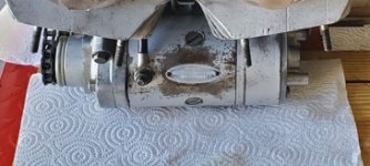

OK, here's more of the small odd engine stuff I encountered along the way that will get left behind if I don't mention it now.
In both pictures above, the green arrows point to the cover for the wires on or around the engine. Most commonly seen cover on the wires from the condenser to the points (RT hand pic) is a small ID woven white fiberglass tube thing. My guess is that this woven fiberglass stuff was, back in the day, more robust and not bothered by heat or any of the other sundry nasty things on or around an engine. However, oddly, this engine also had the same woven (larger ID) white fiberglass covering on the wires coming from the engine dynamo. The norm is a black vinyl-like non-shrink tubing stuff. Now it might be easy to say "ah, that was changed by someone after the fact" until you consider a couple of things. First is that after speaking to the folks who received the bike from Japan I'm not so sure. Their words "we never once touched the engine other than a valve adjustments and new spark plug caps".
That being said, and two, without disrespecting my friends from Montana, I can't imagine a shop there in those early days having an assortment sizes of this woven fiberglass covering to use. Another black vinyl wire cover tube, sure. But this exact stuff? Not so sure. Which is why I replaced it with the same woven stuff and not with what most feel what it should have. It can be easily changed with the engine in the chassis but as I believe in "so you are saying there is a chance" of Dumb and Dumber, as well as my own gut, I feel this is correct on this bike. Do I know this with a certainty? Why, certainly not but too bad!
Another tid bit although most probably realize this. When I pulled the RT hand side engine cover, I noticed the starter chain was all droopy and actually draging on a lug of the engine. Probably would make zero difference over time but that sort of thing drives me bonkers which is why I reduced the slack. It is super easy.
For grins, which has nothing to do with the topic being discussed here, just for the heck of it, the picture on the far right is of the starter before it got some love (left picture is back on the bike)
You can see a couple of the bolts on this bike the left picture, and it is a bit clearer in the RT picture from the parts book. Red circles and green arrows try to show where the bolts are. The point is this: The purple arrows point to the face of the starter that would sit against the face of the engine block when installed. Simply place a shim between the two faces or perhaps better said, between the starter and the engine block to take out slack. I used thin washers around each bolt but you could actually make a shim if wanted. It doesn't take much shim to remove the slack in the chain and as luck would have it the first thin shim/washer I chose did the trick for me. Was the chain tight? Nope, but tighter and had less than half it original slop, At rest, the chain touched nothing.
FYI, the bolts that hold the starter on are Hex bolts and not the Philips shown here in the parts book drawing on the right. OK, on this bike anyway. Sheesh it can be confusing sometimes.
