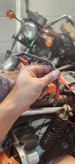

That's my extension wire, I used it because the battery was too far, it has also been taped up to reduce the risk. e0mxXLKY.jpg

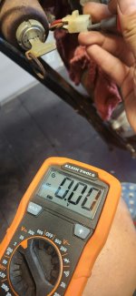

So I tested the ignition switch according to your instructions and the manual. Didn't get anything regardless of ignition position. h3pG5Mu0.jpg

So I tested the ignition switch according to your instructions and the manual. Didn't get anything regardless of ignition position. View attachment 58631
it’s kind of convoluted, but you need to test it with the plug connected to the harness. Basically connect the two block together and use the probe to reach in the back side of the terminal block on the pin.
Like this. Get that little piece of crimped connector with the probe, but everything connected.
Back of the red wire, every key position should read hot.
Back of the black wire should read hot in “run”
Brown should also read hot at one of the key settings (I can never remember what it’s called on the switch).
Then we need to check the ground (green wire) in the headlight bucket for continuity to the negative terminal.
