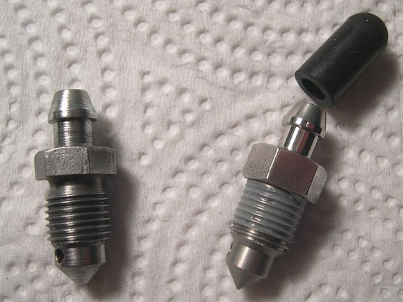

That's the right method, but there is an easier way. You can install a "Speed Bleeder" like the one on the right in this picture. The bleeder valve on the left is the original one for size comparison:
Notice the thread sealant patch on the threads of the Speed Bleeder. That is so that no brake fluid will leak around the body while bleeding, but, more importantly, no air will leak into the system either. The idea is that you can crack the bleeder open, and leave it open till you have gotten the air out of the system. You don't have to do the open/close/repeat, since there is a spring loaded check valve inside the bleeder screw. Just crack it open and pump the lever till the air is gone. Then close it up. It works great!
The company that sells them also has an accessory kit that captures the brake fluid that is bled out in the process. This also works well for flushing / replacing brake fluid periodically, with no mess.
What a great idea. Never knew about these with the built in check valve - learn something new every day! Will definitely look into one of these.
