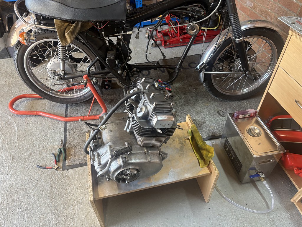

My feeling is that in the fullness of time (next winter) I'll end up stripping the bottom and to check everything and change the cam chain. The project so far has established that the CB200 is basically sound and worth investing a bit of time in. Once the seaside house is well established (there are a few building and remodelling projects to complete there this summer) I can return to the CB200. In the meantime it is running and riding (with a list of things that need fixing one day).
