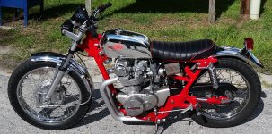

Neither, it's the stock CL fender. I'm guessing the 500T fender would fit yours no problem since they both have disc brake. The CB fenders don't have the tendency to crack at the rivets where it's attached to the mount because of the braces. All 4 rivet holes on my CL fender have cracked over the years and I drilled right next to them and used big head JIS screws and nuts underneath to stop the cracks from spreading, it's been fine for years now but still looks a little weird with the screws in it.
Thanks, I am kicking myself for letting a really nice 500T fender I saw on ebay at a reasonable price get away. BTW ran across this pic of Red while browsing where you were discussing seat height with another user on Reddit.
Well, I'm not used to seeing pictures of my bike posted by someone else :ROFLMAO: and that's an early pic, note the cheesy aftermarket passenger pegs that drooped in the first week of use and the Honda/Team Hansen CR450 stickers on the tank. And no reinforcement screws in the front fender then either, the first two spots happened in late 2019 when Chris and I rode the Copperhead Loop between Waynesville and Brevard. I discovered it after the ride, and the other two happened not long afterward.
