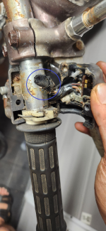

Hey everyone, it's me with the broken CB360. I'm trying to get the bike started and I'm continuing to have issues. I've replaced the ignition and fuse with a 4into1 version. I've also replaced the regulator/rectifier. The solenoid clicks when I connect it to power and the starter motor also works. However, the only way I can get the engine to turn over is by jumping the prongs on the terminal. At this point I'm pretty much stumped since looking at the wiring diagram everything should work. The only thing I can think of is that the killswitch/electric start connection is bad so I'll take a look at it tomorrow. Does anyone else have anything recommendations for what else I should be checking? I haven't looked at the points or condenser yet but I know I'll have to adjust or change both. Here's a picture of what wires I switched. When I connect the two prongs with the pliers on the solenoid the engine turns over but it results in the plier basically welding itself to the solenoid which is obviously not ideal. Any help is appreciated. I've also attached a video showing it.
