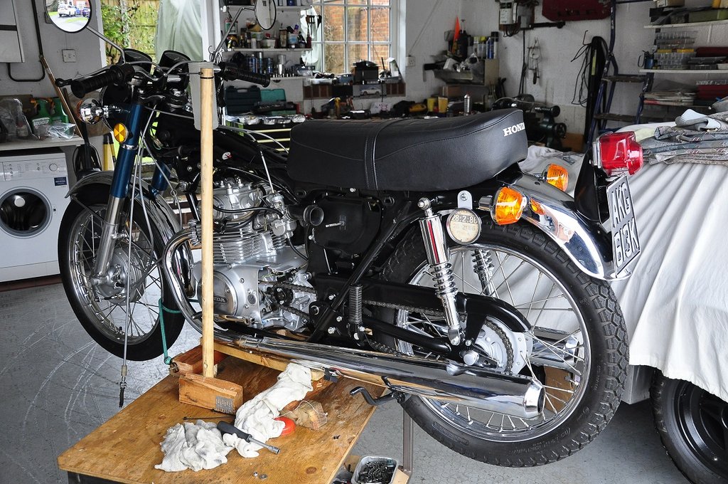

See above in Blue.....They are never "done".... Maintenance is a constant requirement......Got to the end of the general tidy up of the machine, rear chain on etc and while it was ticking over (1500 rpm indicated) opened the idle mix screws a 1/4 turn more, so both at 1/75 turns out from tight which made it sound better still.
ANY "tickover" speed in excess of maybe 50 RPM above specified idle speed puts you partially on the main jetting, not just the idle jetting ......
Adjusting the mixture screws there is futile and may be leading you astray.......Try getting it down below 1250/1300 before tinkering with the mixture......
Tried switching on the lights while it was running and immediately the engine stopped. This has never happened before, so i suspect that generator loom. Alternator working or not (disconnected) should have ZERO effect on engine running if battery is good....Racers run "total-loss" all the time....

Finally tonight I removed the plugs after the light switch had stopped the engine. Both black sooty and dry, but both the same, so running rich and one carb can sometimes flood/overflow so thinking of a full jet/needle/seat kit for the carbs.

Thank you Steve, the lights switching the engine off is strange, but I'll do the generator loom check anyway.
Are the Honda tachometers accurate as the engine sounds very slow compared to the needle position.

My money is on the switch too. The engine stops immediately I turn it to running/lights on (3rd? position) so, generator wires then the switch this morning.
Ignition switch is the same US or UK, OFF / RUN /OFF with parking tail light.
The pilot air screws do nothing so are both at 1.25 turns out.
Not sure Ihave a problem to solve on this bike!
