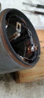

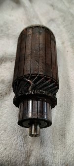

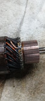

Found the problem and have repaired the starter motor. I had to resolder the armature and field coils. I forgot to take a picture of the final field coil repair. The end solder joint is new after I bent it back in place, then I soldered the bad joint to the left of it. Used a heat gun to get the surrounding area temperature hot, and some liquid flux allowing the solder to flow easily. Also installed new brushes, o-rings, and bearing from a rebuild kit. It really wasn't worn, just really dirty. Installed it on the engine and tested the operation. Appears it works as good as new.
Pictures tell the story.
