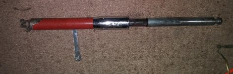

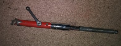

They are pretty fine threads. I figured mine were stuck good and any pin type tool would either shear the pins or tear up the chrome seal housings, so I made the wood blocks. Glad I did. After you are done with the evaporust process, you'll need several soaks with PBblaster for sure.
On the Black Bomber in my garage I soaked those threads with penetrating oil every day for about a week, then secured the lower part of the shock in a vise, heated up the chrome cover with a heat gun on high, put on some rubber faced work gloves, grabbed on to the chrome cover and just about blew out an artery or two turning it. It worked. The gloves melted a little from the heat but I spent at least 10 minutes congratulating myself.
