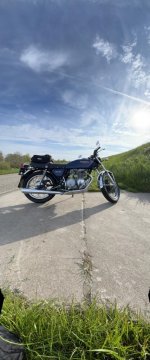

This long weekend (due to Kingsday), I reached the first 1000 km. Replaced the oil and filter and checked everything today (loose bolts, leakage etc). However, it's not running as it should, between 3K-5K rpm the engine doesn't run perfect. One header pipe is a little hotter then others, so I think I have to wrench again. I have to work on the engine anyway, since the head bolts needs to be re-torque-ed, taking the carbs out is just an extra point on the list while I'm in there.
Since the issue's are between 3-5K rpm, the issue is complex. This area of rpm has three major influencers, being the stationary jets, the float height, and last but not least, the throttle slides cut-of. Needle hight is ok, because it picks -up good from 5K to 10K. I'll start with chancing the float height and increase with 2 mm and go from there. Giving the engine more fuel in that region, will also interfere with the stationary mixture, so the mixture has to be changed as a result of that. that also will fix the header pipe temperature, because I think the major reason for that is uneven float heights.
Changing the stationary jet doesn't solve much since it's running perfect between 1.2K - 3K rpm mixture is good too. Changing the needle height doesn't fix it either, since this is the area that the needle is straight. Changing the throttle slide cut-away, thus changing the throttle slides is difficult, try to find them !
2mm float change is a rather large one
Yes it is, however, the issue's around that rpm era are also big. I have to close the choke a few % to get a workable mixture, we guess that represents close to a 2 mm float high, based on my opinion and from my dyno-friend. It also depends on how much difference I measure between the float heights between the carbs. If the float high difference is large between nr.2 (blue-ish header) and the rest the float height difference will be set less then 2 mm. However, I cannot imagine that I introduced such a difference while assembling the carbs.

1900 km's and counting. I took the bike everyday to work, every day at least 120 km, plus "extra" km's taking the long way home. Next week I take the CB450 K0 out again, otherwise it will get jealous.
Lovely looking bike. A chap in our bike club back in the day had a brand new blue one just like yours, I was very envious. First thing he did was to remove the stock silencer and replace it with pattern 'Dunstall Decibel' pipe, cut and welded to give it an upswept angle. Sounded ( to my teenaged ears ) very nice ..

After breaking in the CB400F, and put it on the bike lift for the earlier mentioned work, I took the CB450 K0 to work today. I was forgotten how agile this bike is compared with the "lump" CB400F, and I love the availability of torque compared with the CB400F. Earlier measurement show that the CB400F and the CB450 have more or less the same power, but the way it's delivered is so different.
On the way back I had very heavy rain for an hour, but the bike brought me home !
I'm surprised the difference is so large that you would use the word "lump" to describe the CB400F, but it's interesting to hear your comparison. Riding the two bikes in close succession and on a familiar route makes for a nice test. I guess you don't expect the planned float height adjustment to substantially change the calculus on this head-to-head comparison?
