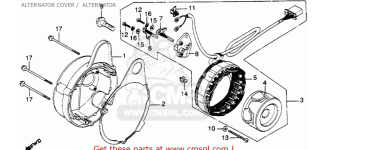

I am working on an 81 cb900c, a previous owner left the starter out of the bike for an undetermined amount of time, and took the bolts out of the stator housing ( I believe it is anyway) I don't think they removed it, if they did they put it back on without bolts. They also removed the rubber hose from the crank case vent. I know some dirt got in due to being open and a mistake of mine. What do I do to prevent any damage?
When you say "left some bolts out of the stator housing" - which one(s) are you talking about?
And dirt got in where? Just the EGR tube? What kind of dirt and how even?
Get some cheap oil. drain what's in there. Fill, run for a bit, drain. Swap filter.
OK - That little bit of dirt on the gear is a non-issue. It'll get eventually flushed into the filter. for a variety of reasons, you're going to want to change the oil now and again really soon after it's run for a bit.
That it the left side crankcase/advancer cover. Stator is on the right side next to the clutch. You're likely going to need replacement gaskets
Point cover part number 30372-425-000
Cover gasket part number 11395-425-306
You'll also need 6 M6X32 Flanged bolts and 2 M6X40 flanged bolts from a Honda auto dealer (fastest/cheapest - no shipping)
32's are part number 96001-06032-07
40's are part number 95701-06040-08
