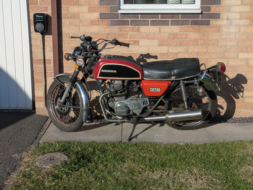

Here she is when I bought her in January, having stood for 23 years

Interesting starting point for you, receiving an example that already has a repainted tank, non stock mufflers, engine protector, and can't be sure from the provided photos but you might even have non stock triple clamps as that rake angle looks just a bit more extreme. Nifty. Also envious of the luggage rack.
