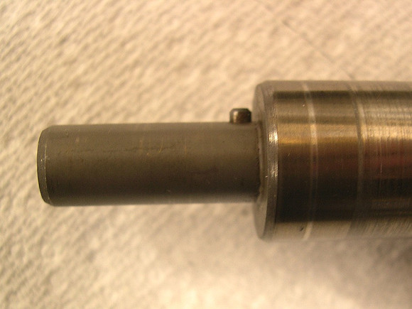

The actual problem IMO is the keyway in the shaft. The end of it aligns with the oiling port on the other side so any pressure built there is bled off. My solution is to fill the keyway leaving just enough room that the keyed thrust washer will fit with the circlip. Polished on the bearing surface and now the pressure should be as good as it will ever be.

One precaution is that you should see if your kickstart shaft is necked down in the spot where the gear was running. If so, you may need to rework (or replace) both the shaft and the gear bush. Otherwise, if you redo the bush to make it fit the reduced diameter of the shaft, you may not be able to slide it over the larger end of the shaft. Hope that makes sense.

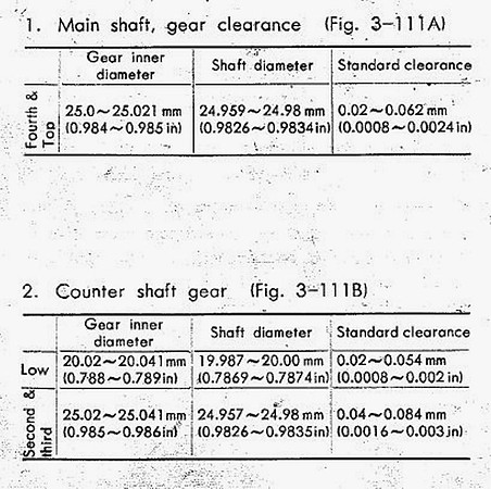

Jim, I understand the differences in the kick starters from the SL350K0 to the K1/2. If your FSM that extends through the K1/K2 bikes simply refers the user back to the regular CB/CL350, we may be looking at the same book.
My point was that, absent the usability guidelines for the kick starter idler and its shaft, Dave could still measure his parts, calculate the diametral difference, and look at the usability guidelines that are provided for transmission gears. Honda would have had similar engineering standards for those, which are simply gears freewheeling and/or sliding on a shaft. For example:
They designed fourth and top gears to have ,0008" to .002" clearance. Although they did not provide the maximum clearance before replacement, it would be safe to say that if it exceeds 1 1/2 times the standard, it needs work.
Similarly, they called out ,0008" to .002" clearance for low gear, and a range of .0016" to .003" for second and third gear.
I realize that these are not specs for the K1/K2 kick start idler fit-up to its shaft, but it gives an idea of what Honda thought was acceptable for similar applications. It is probably better than a wild guess.
You could say I am comparing apples to oranges, but I think I am zeroed in closer than that -- maybe more like oranges to tangerines.

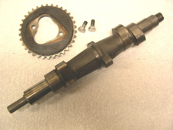

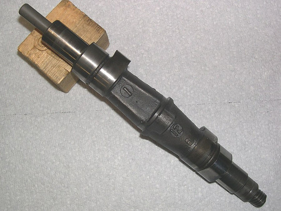

In regard to my K0 camshaft with the groove on the end, I would not swear in court that it has never been changed out, but I will say that I am at least 95% sure it is original. A friend of mine bought this bike as a complete but very rough barn find. He tore it down and put it into boxes, but lost interest before he ever went so far as to buy any replacements, whether new or used. I inherited the contents of those boxes.
The FSM I am using is the CB250-CL250-CB350-CL350 FSM, which also includes a supplement to cover the newly released (back then) SL350 K0 model. I think I got this manual from you about 10 years ago, so you probably know the book I am talking about. The SL350 supplement lists nothing specific about the camshaft. It refers the user to the data in the main CB/CL section. My cam agrees closely with the base circle and lift dimensions provided for the CB/CL camshaft, yet my cam does have the groove on the end. Here is a picture for you:
The above ^^^ pic looks the same as a fat boy groove cam from my collection.
I swear we're going to figure this stuff out on all the camshafts:lol:
Partzilla and CMSNL both agree that the KO used the 050 cam up to engine # 1026008 and then the 060 or 070 from 1026009. Here's the picture of the 050 and 070 cams
Your picture is showing a fat cam which makes it and 040 or earlier. Damien, aka ausman1000, posted a picture of the odd ball cam he has that has a groove and an almost fat cam body which I think is a K1/2.

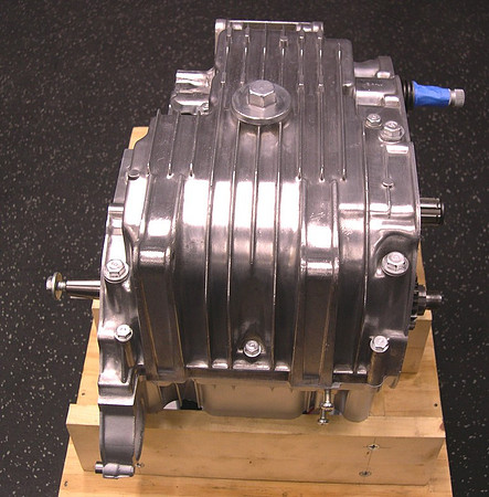

I've been spending the last couple days cleaning the upper and lower cases, along with the hated clutch/front sprocket area. On this bike, the upper case was clear coated from the factory but half of the clear was missing and the rest was yellowed and nasty so I stripped it off. The lower case was not cleared. As you can see, there is still a lot of elbow work to do.....
Anyway, the plan for this bike is to paint the cases that were originally painted silver, and leave the crank cases and cam covers in bare aluminum. Any thoughts on clear coating that top case like it was originally? Or should I just leave it.... Part of me thinks clear is the way to go, but I would think the bare aluminum would be fine and easy to clean...
If you clear coat then you need an epoxy type clear so when the cabs leak the gas doesn't ruin the clear.
If you leave it raw then you need to clean/power wash the engine on a regular basis to wash off anything that will set up corrosion.
Kind of a damned if you do and damned if you don't
