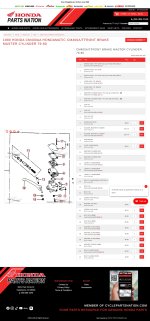

There should be a metal shim plate between the cap and the diaphragm... #10 in the screen-shot... 1778949385760.jpeg
on a couple of masters ive had on CB s, no shin but rubber cap, between base and lid. I supposed to stop splashing. Also is the master the original or another Honda model or even a after market. Im having trouble with a replacement Chinese master unit, that doesn't seem to to have enough guts, but would add my bike somewhere along the line, has had a twin cb400 front fork upgrade down. Now was the original 250 master, man enough to deal with the twin calipers. awaiting a master unit witch seems to match the original and made for 350 upwards.
My Hornet master cylinder looks very similar to yours. Mine has a convoluted rubber thing (9)that sits on top of the fluid in the master cylinder, metal plate (23) sits on top of that. Rubber thing forms the seal between the cap and the reservoir. Often wondered how this all functioned, just seemed to be a messy way of going about things. No obvious breather vents.
If you open the cap of any master cylinder you will see a diaphragm similar to # 9 in the diagram above. It acts as seal preventing out side air and humidity from contaminating the brake fluid (DOT 3 will suck up moisture) and it acts as bellows so that as fluid is displace by brake shoe/pad wear it will get pulled down into the reservoir so there is no negative pressure pulling the fluid back up..
