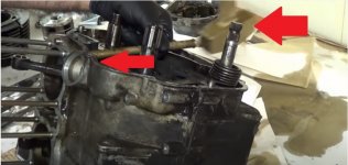

To expound, for those who have not seen any of these videos utilizing such poor techniques, here are a couple of screenshots (edited to avoid maximum embarrassment, though they know who they are)
For those who may not be familiar or do not realize the implications based on the visual, in the first picture the red arrow points to the cam chain still connected while they are forcing the cam bearing off the camshaft. The cam chain should be broken at the master link and the head removed, then the cams turned to the point where no valves are open, before proceeding with disassembly of the cylinder head.
In the second picture, they are using a brass drift and hammer to hit the upper case in an attempt to disassemble the bottom end of the engine - despite the shift shaft still being in the lower case and engaged with the shift drum, and despite the simple fact that the lower case lifts off the upper case when done correctly because all the internal components stay in the upper case (not the least of which is the crankshaft, which is bolted to the upper case with a 4 bolt cap)

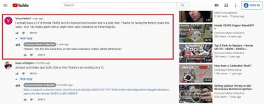

Another submission from the so-called "experts". I guess they like vintage Honda twins but still don't think the factory knew what they were doing when they designed and built them. Amazing.
https://support.those guys in Houst...rance-specs-for-the-Honda-CB450-CL450-CB500T-
I can't comment as I have recommended .002" so those inexperienced with "feeler" gauges err on the safe side if they get a "tight".002"......
I set mine at .0015" as that size gauge is widely available in US spec sets, and very close to spec.......
Setting them at .002" as opposed to .0015, or even .0012, isn't nearly as much as just saying they need that much more than factory spec to set them at .003". They have the FSMs on their own website, guess they know better. I suppose they think it will improve cam lobe and follower life or something
With a freshly rebuild 450 it's wise to have the gap slightly wider, but after a few heat cycles follow the FSM's.
