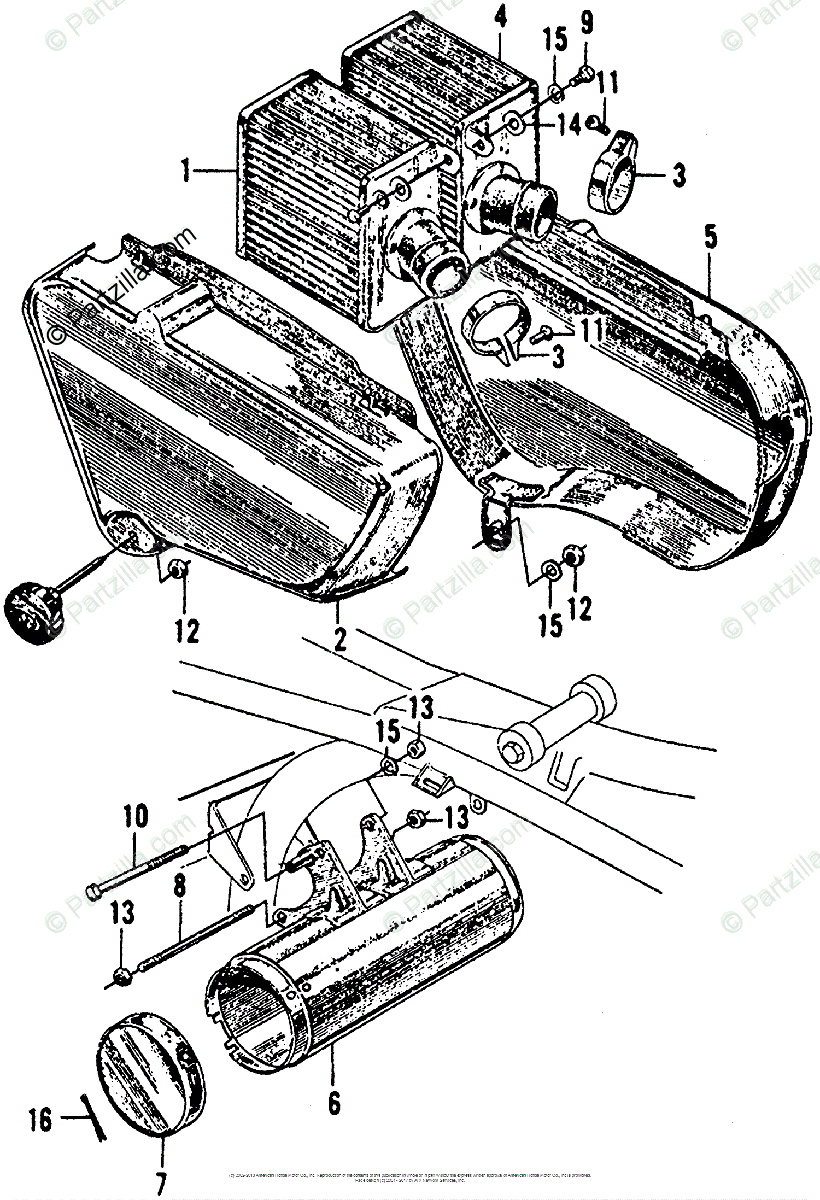

So what's everybody doing for air filters?

This is the filter I've got, looks in ok shape to refit with foam, I'm not quite sure which side it is though...
Left I think?
Any idea where I'd find another? I guess I'll post in the parts wanted sections and see what pops up.
Left I think?
I asked on the CB160 FB group and got this. What would they be worth to you? And shipping from CA.
Sorry just shots of my computer screen. Can't link to FB messenger. He didn't know about refurbishing and no clue what 's the worth.
Alan,I hope the FB seller will let you have them for $20+ shipping:those filters could be re-fit with green Uni-foam as some of have done using the stock metal frames from the original filter elements.

He just said $50 including shipping
I actually spoke with a friend about these today, he dabbles in 3d printing and will have a look to see if anyone has uploaded a design for these, wouldn't that be something?

I pm'd you Alan. He offered $50 including shipping from west coast. I said, sounded fair. He said they're not going anywhere. I said we have hoards of CB160 restorers (just kidding):neutral:
