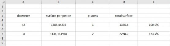

Indeed, two opposing pistons, diameter 38 mm each, the original piston is 42 mm. Below a calculation of the impact:
Since the piston of the brake reservoir stays the same, the travel will be smaller, but the applied force larger. At the moment I have Ferodo brake pads in the original set-up, but still I like to have more brake power. Also thinking of changing the disc itself, but that's another path I like to avoid.

Good question. I'll be curious to hear what Jensen has in mind as well. I suppose it may be a good thing that the original rotor/disc was not drilled, because that leaves a fairly easy upgrade that could help with heat dissipation.
The main reason for the low break force lays in the difference between the two pistons (lever versus caliper). Honda was experimenting in that era, this was one of the first disc brake setup, and is actually the same as on all 450's from 1970 and up. The disc itself is very thick and heavy, the mass alone will make it difficult to heat it up quickly. Eventually, it will heat up, but that takes a serious amount of breaking, way more then everyday usage (at least that is my experience wit this bike). The disk itself has a smaller diameter then modern set-ups, resulting in a lower torque-arm with respect to the centre.
Perforated disks don't brake better, probably worse, because there is less surface to be used. For breaking in a wet environment the perforation will help to get rid of water and dirt. Most brakes from cars are fat disks, not perforated and enclosed by the mudguard and wheel, more or less the same as the Honda CB400f. Most cars have multi piston calipers, which making the friction surface larger, resulting in more stopping power.

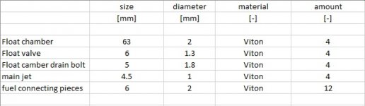

I decided to replace all NBR O-rings rings for Viton O-rings since the NBR cannot stand high percentage ethanol gas over longer periods. Viton is costly (almost ten times more then NBR), but worth the effort and costs since the ethanol percentage in gas will increase in the near future.
Since I also want to replace the needle and needle jet, the carbs need to be completely dissembled.
These little parts are causing the most leakage, I replaced the O-rings not only by Viton, but also by thicker diameter (original is 1.8 mm, now 2.0 mm). The diameter of the part is 6 mm, the ID of the hole they fit in is 9.3 mm, so 2 mm thickness makes the total diameter 6 +2+2 = 10 mm. The deformation of the O-rings are a little larger then should be, but since the width of the slot is 2.6 mm, there is room enough to go to.
