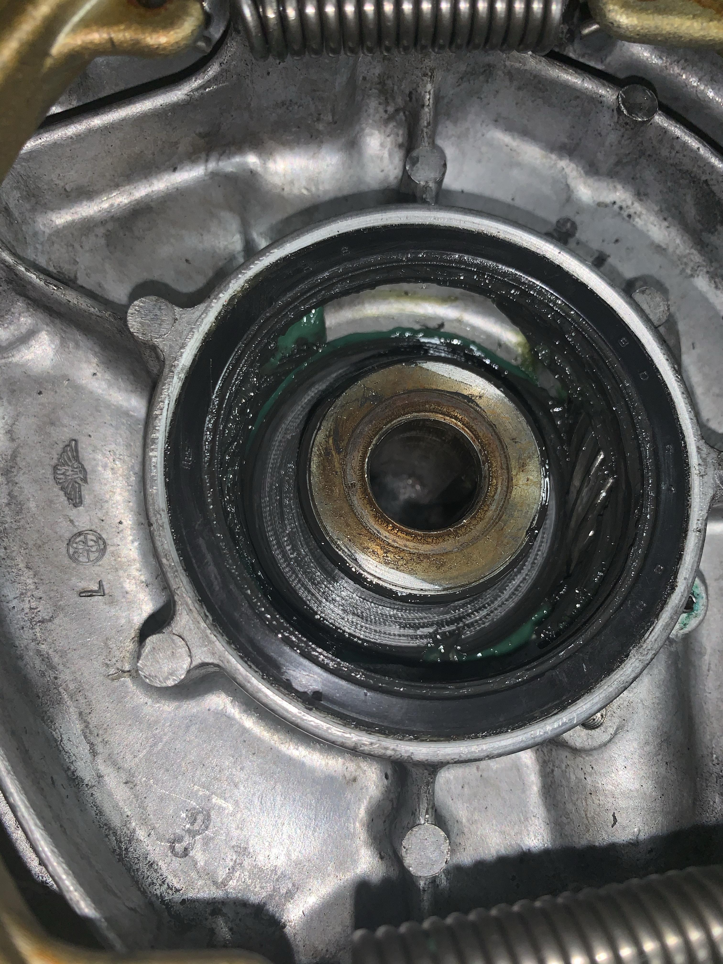

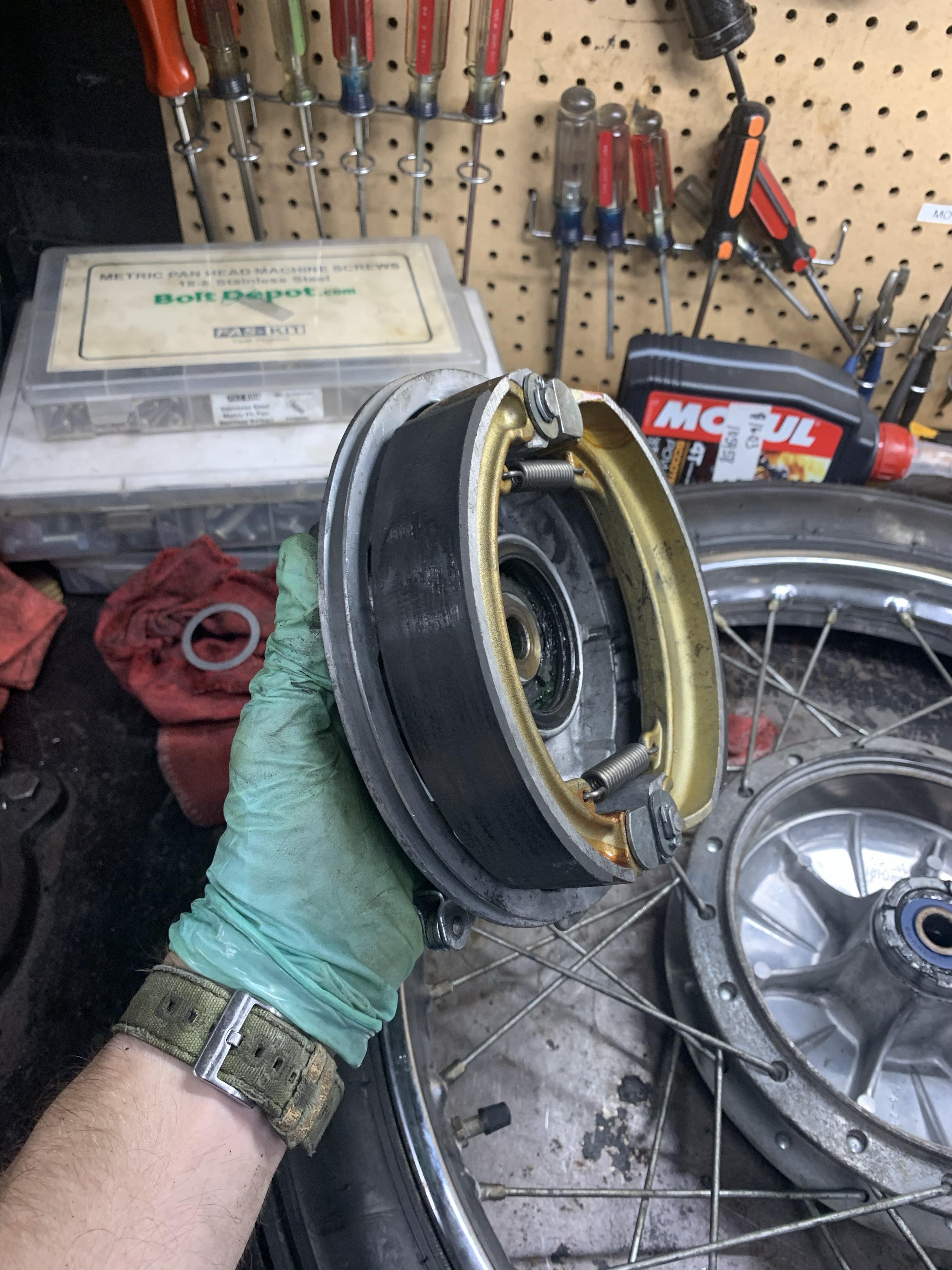

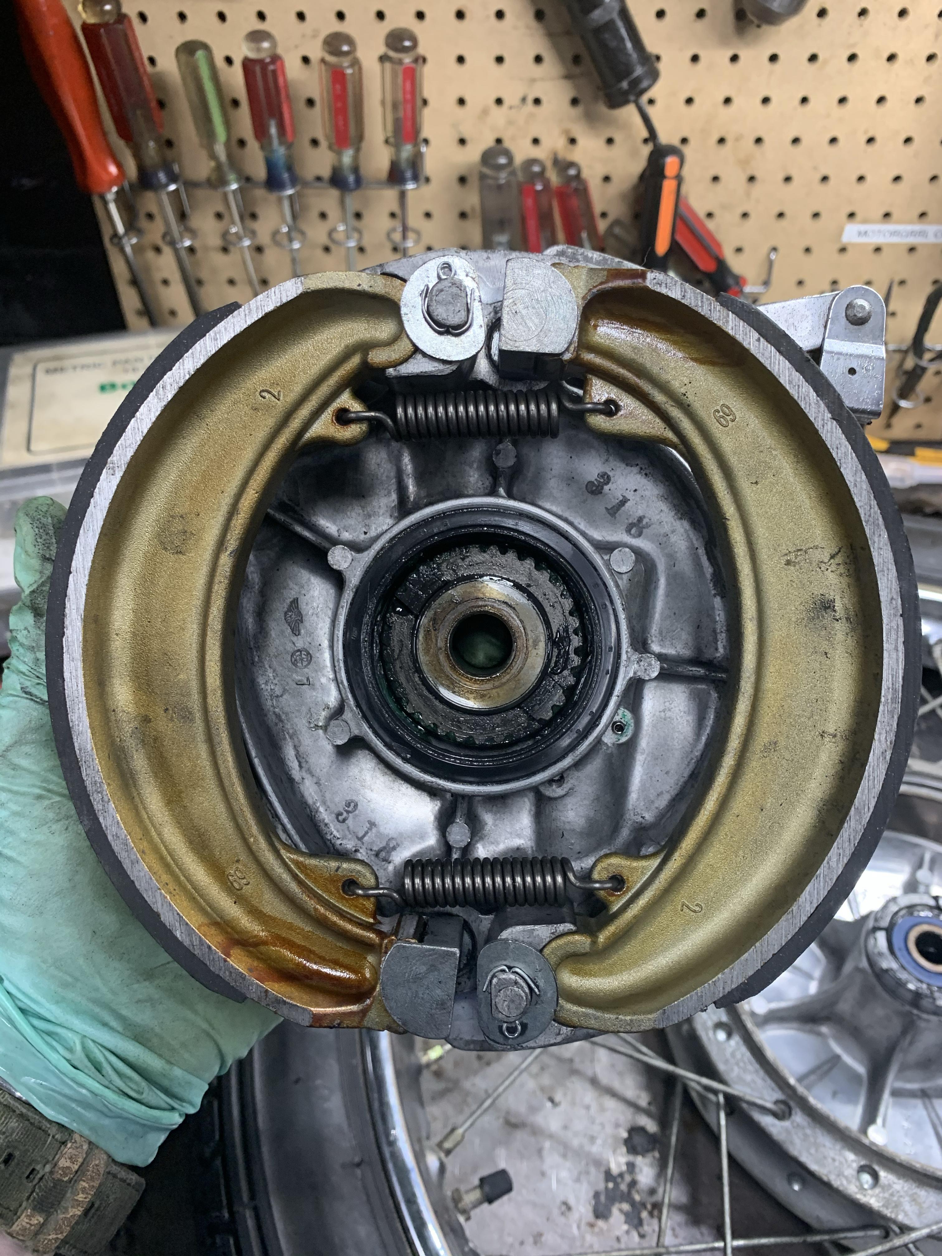

Here’s what I got.
All the parts are there (including the second speedo washer that was just smushed so tight I didn’t find it the first time).
The place looks clean. I’ll re-do the brakes so they don’t look so wonky (arms parallel).
Any thoughts? Measurements to take? Obvious “duhs”?

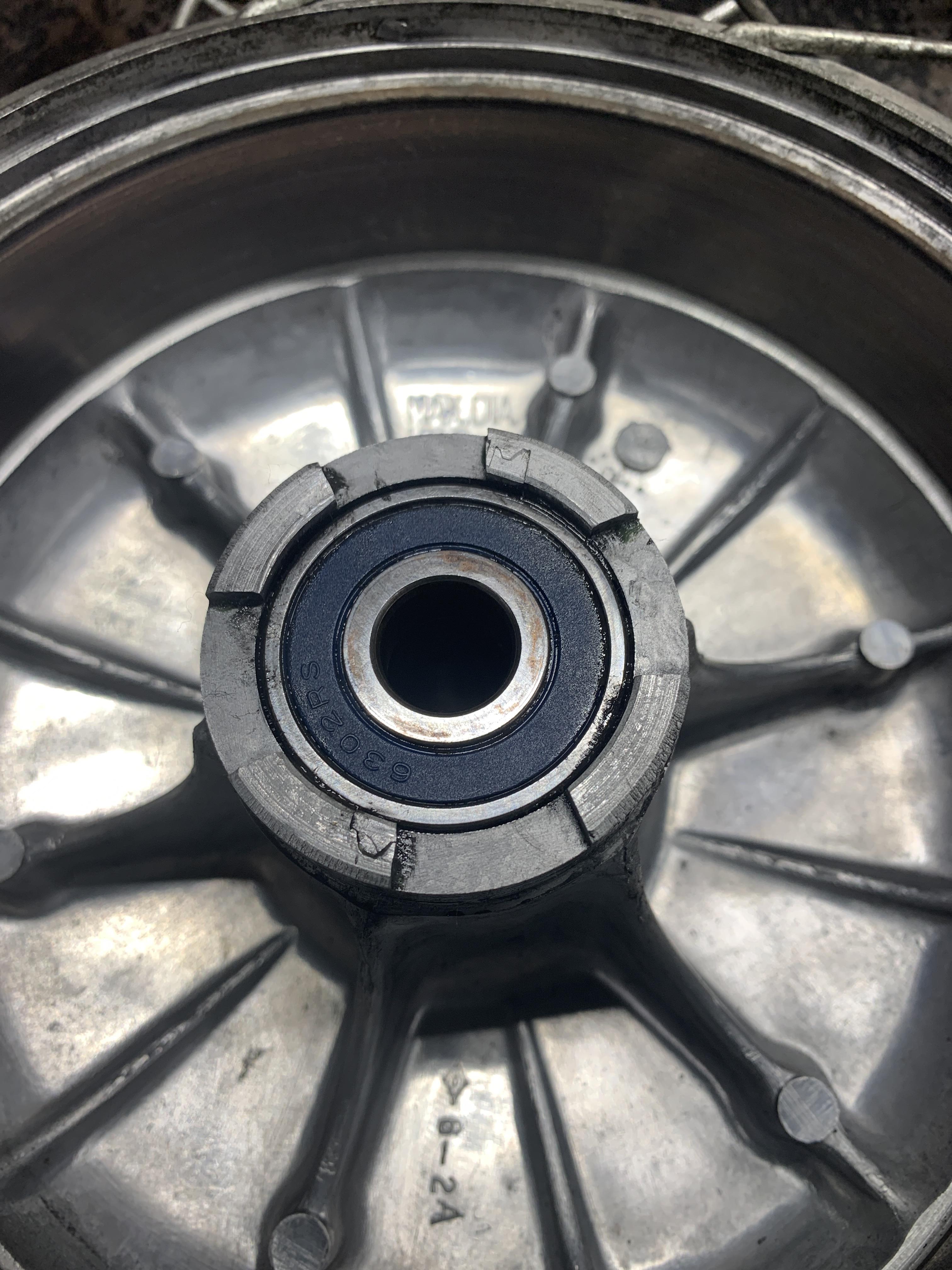

I don't see anything obvious, but a bad bearing wouldn't necessarily be obvious in a picture. I did see this though - looks like the tabs from the speedo drive were forced onto the hub and not aligned into the notches. Makes me wonder if that was before the noise or after.
"Clunk clunk clunk" somewhere in the front end
Good eyes, Tom! Definitely looks that way. Not sure either, but really hope that was before my ownership of it!!!
Yep, you can see where it wasn't lined up and dented drive dogs on hub.
